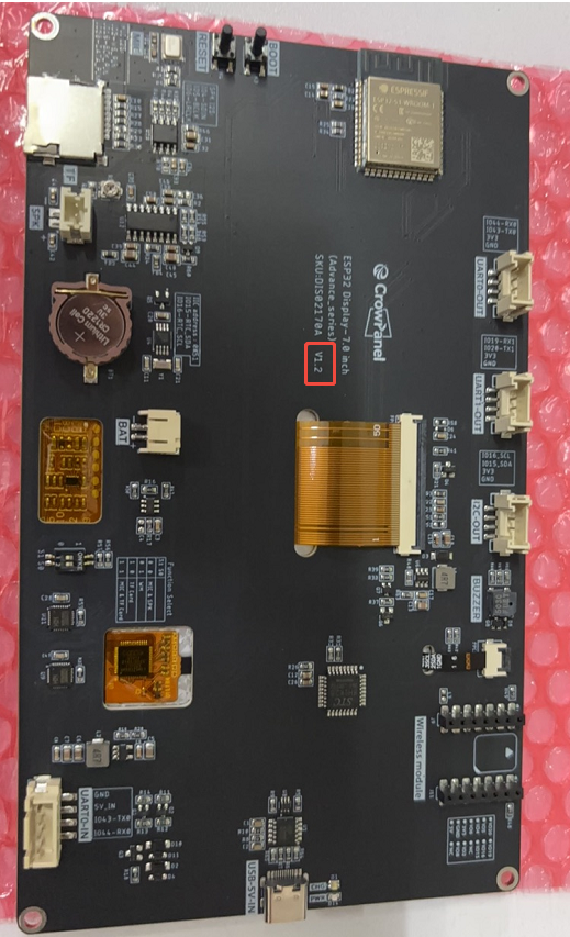

What is the difference between CrowPanel Advance 7.0-HMI ESP32 AI Display v1.0 and v1.2
edited August 2025 in Elecrow HMI Display

  • I have purchased 8 CrowPanel Advance 7“ HMI| ESP32-S3 V 1.2, and the codes for version 1.0 are not working on these screens, version 1.2, black screen, please what is the solution?
