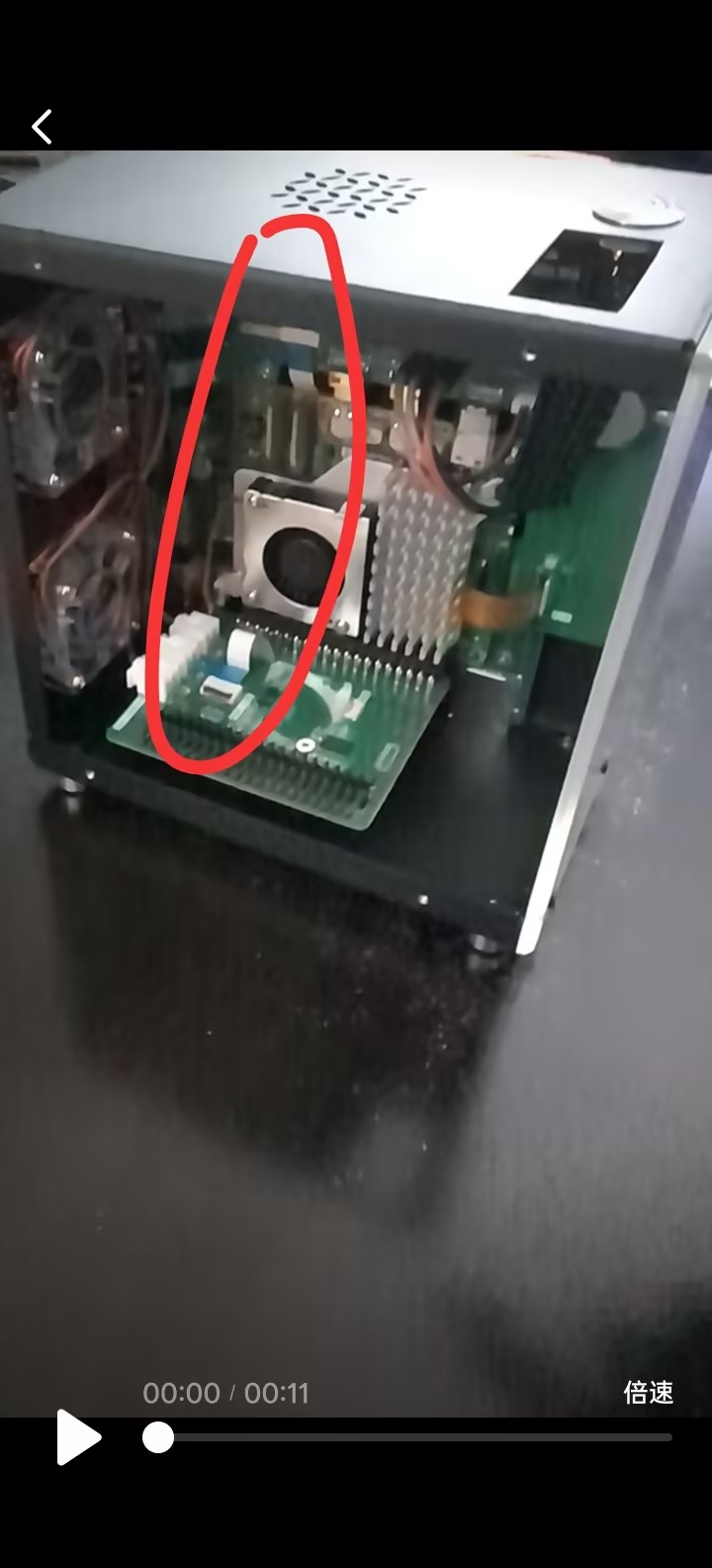

The power button on the elecrow mini pc case does not toggle. It only turns power on when fully depressed. I purchased this from Amazon, and have it put together, but cannot get the power to stay on. If I hold the button down, the pi does start loading and I am able to see the loading screen.

Regarding the issue of not being able to power on normally, please first check if the cable shown in the image below is installed correctly and whether the latch on the corresponding slot is properly engaged.
[Photo]
(Image can be enlarged)
The steps for installing the ribbon cable into the slot are as follows, please refer to:
a. Lift the latch
b. Firmly insert the ribbon cable into the slot
c. Press down the latch to lock it in place
This usually happens when the power button ribbon cable is not fully seated or the latch is not locked.
Double check that the ribbon cable is inserted straight, pushed in all the way, and the latch is firmly closed. Also confirm the cable orientation matches the board marking. If it is seated correctly and still only powers on while held, the cable or button board could be faulty and may need replacement through the seller.
