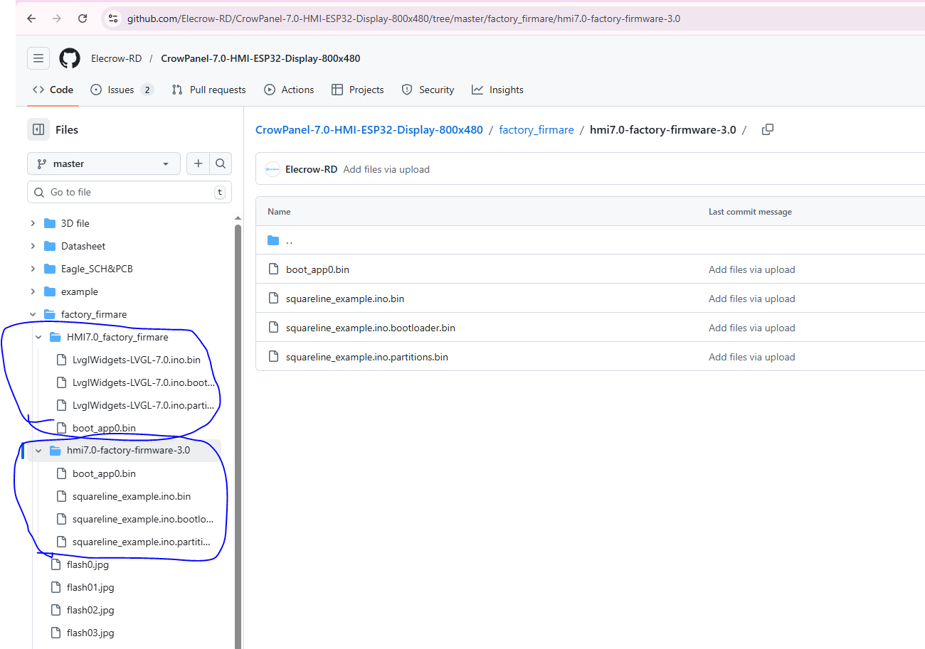

    Hi James,
    This is the factory firmware: Pls choose the factory firmware according to the hardware version of your device.(It is on the back of the board.)
    https://github.com/Elecrow-RD/CrowPanel-7.0-HMI-ESP32-Display-800x480/tree/master/factory_firmare

  • Hello,
    I’m working with a CrowPanel 7.0 HMI ESP32-S3 unit and I want to confirm I’m following the correct factory restore / flashing process.
    I successfully downloaded the package labeled hmi7.0-factory-firmware-3.0, but the contents appear to be Arduino source code (example → Arduino → arduino_code) rather than precompiled .bin firmware files.
    Before proceeding further, I just want to confirm:
    Is the intended factory restore method to open the provided Arduino .ino project and upload it via Arduino IDE to the ESP32-S3?
    Or is there a separate set of factory .bin firmware files intended to be flashed using the ESP32 Flash Download Tool?
    Right now I can see and open the Arduino source correctly, but I want to be sure I’m restoring the panel exactly as intended for my specific SKU before flashing.
    If there is a recommended board profile, partition scheme, or specific Arduino settings for this panel, please let me know.
    Thank you for your help — I appreciate it.
    Best regards,
    James Hart

    Dear James,
    The link I provided earlier contains .bin files; please take a look. It also includes instructions. Just follow those steps.
