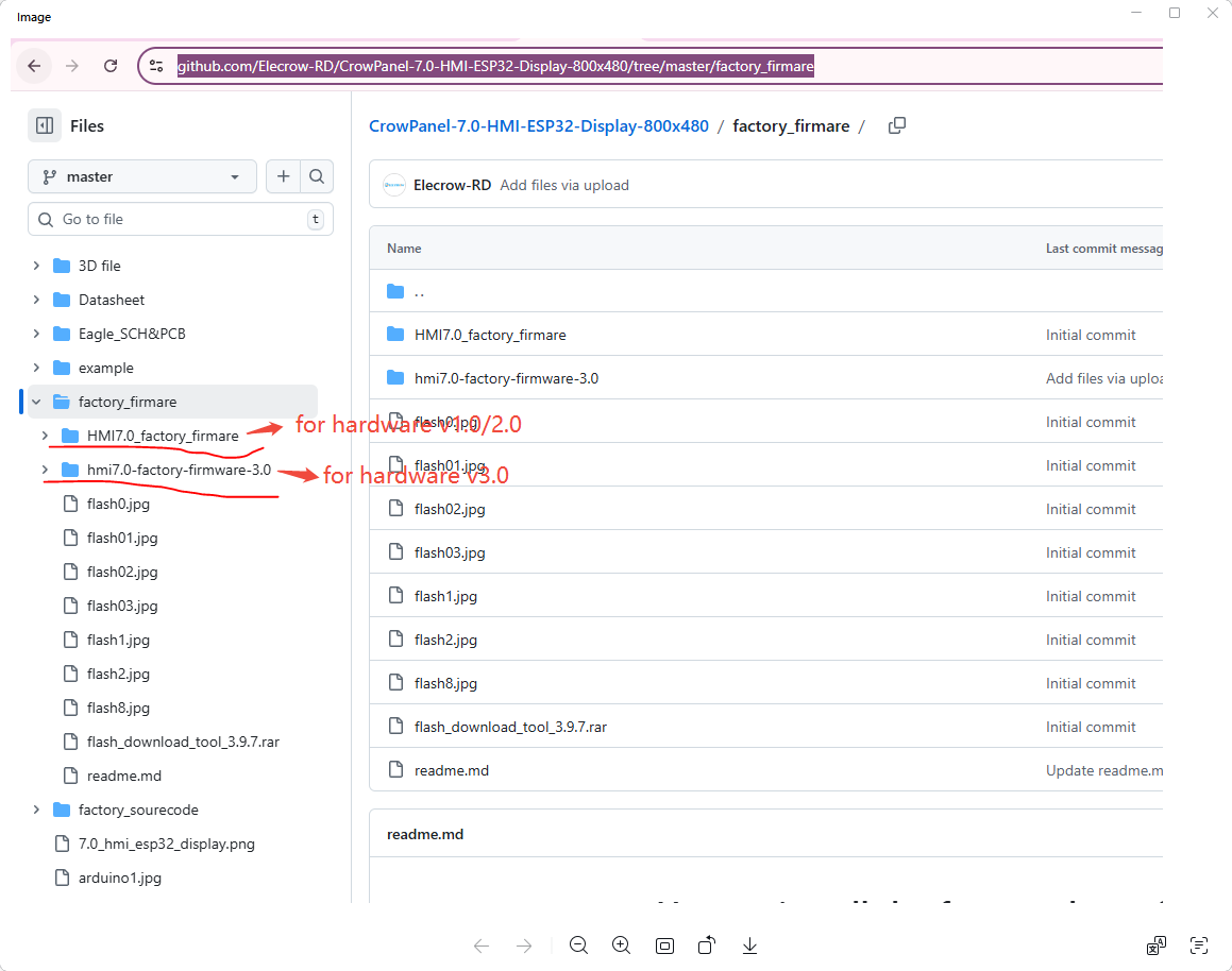

Hi James,

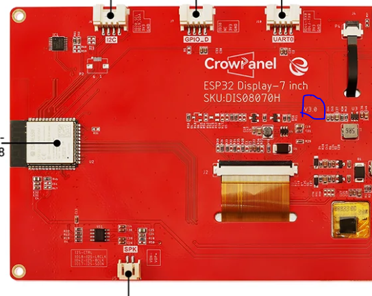

This is the factory firmware: Pls choose the factory firmware according to the hardware version of your device.(It is on the back of the board.)
https://github.com/Elecrow-RD/CrowPanel-7.0-HMI-ESP32-Display-800x480/tree/master/factory_firmare
An example of a hardware version of HMI devices :
