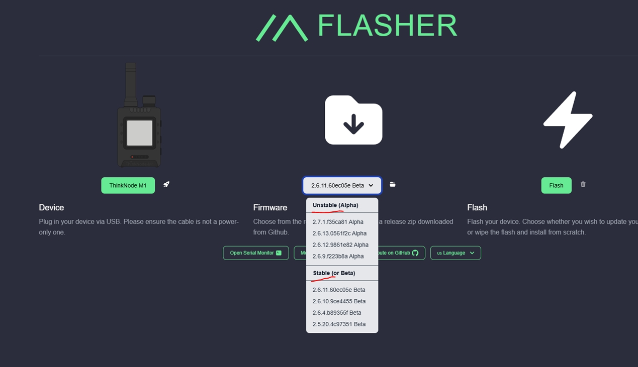

Please try the following.
1 Have you turned on the GPS switch?
2 In addition, the device must be placed outdoors to have a GPS signal. Is the device placed outdoors?
3 Please update your device to the latest firmware (both stable and unstable) and try again. The firmware update link is below.
https://flasher.meshtastic.org/
4 Maybe there is a mistake in the settings in the app. I suggest you try this: click Restore Factory Settings in the app, and then turn on the GPS switch on the device
5 If the problem still exists, please open the case and check if the antenna is loose or not fastened properly. If so, adjust the antenna and fasten it properly and try again.
