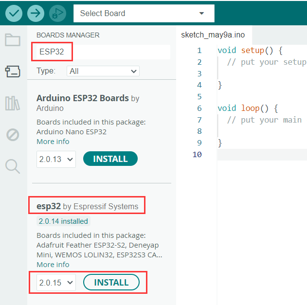

    Which esp32 version did you install? Please makesure to install esp32 version 2.0.14/2.0.15. Installing other versions will cause errors. Please refer to this link for installation instructions:
    https://www.elecrow.com/wiki/Get_Started_with_Arduino_IDE.html#add-development-board
