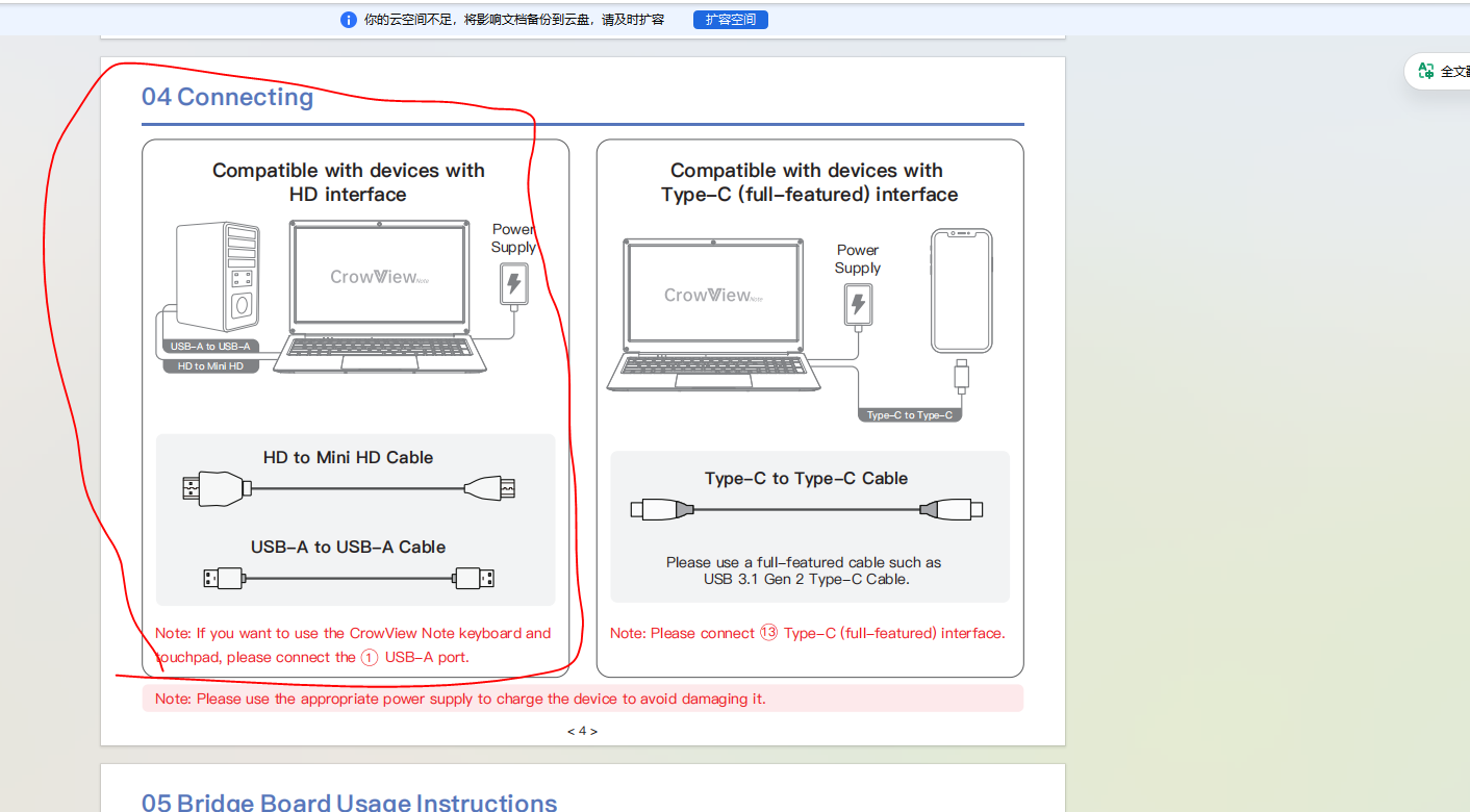

"here is the mini PC , TRIGKEY Green G5 Mini PC
just checking if the CrowView Note support Mini PCs other than RPi, Jetson Nano, and other common SBCs? "
Answer:
"Does the TRIGKEY Green G5 have both HDMI and USB ports? If so, I suggest trying the following connection method (because HDMI offers better compatibility; generally, as long as your computer has both HDMI and USB ports, you can use Crowview Note). [Photo]
