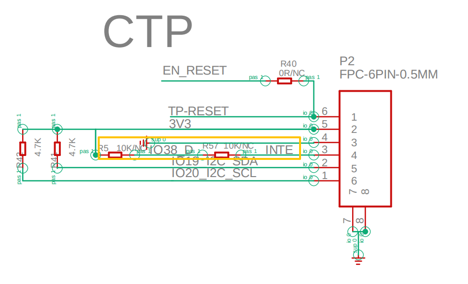

I'm using the 7-inch basic crowpanel. For this application, if I want to put the application to sleep and then wake it up with a finger, how to do it? .
Answer:
We apologize, but our motherboard does not have a 0-ohm resistor connected, so the touch-to-wake feature cannot be implemented.
[Photo]
