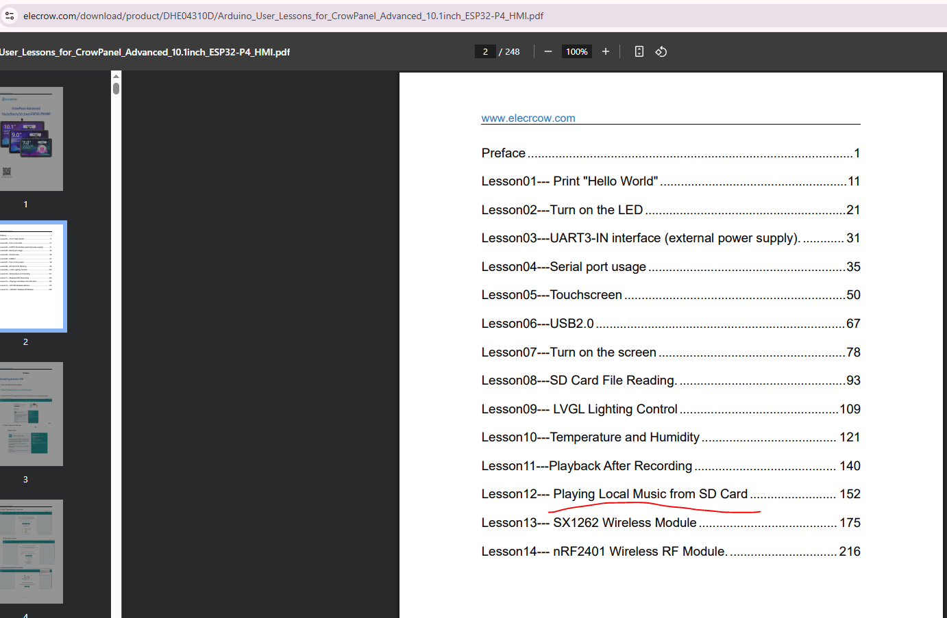

  • Dear nickp,
    If you are using our sample programs and encounter compilation or runtime errors, you can contact us for assistance.
    If it's your own program, you will need to troubleshoot it yourself. I am sorry, we generally only provide technical support for hardware and our sample programs.
    Furthermore, we generally recommend that customers use our sample programs first and then modify it to implement their desired functionality. This is faster and more convenient.
    here is a related sample program:
    https://www.elecrow.com/download/product/DHE04310D/Arduino_User_Lessons_for_CrowPanel_Advanced_10.1inch_ESP32-P4_HMI.pdf
    Sorry for the inconvenience.
