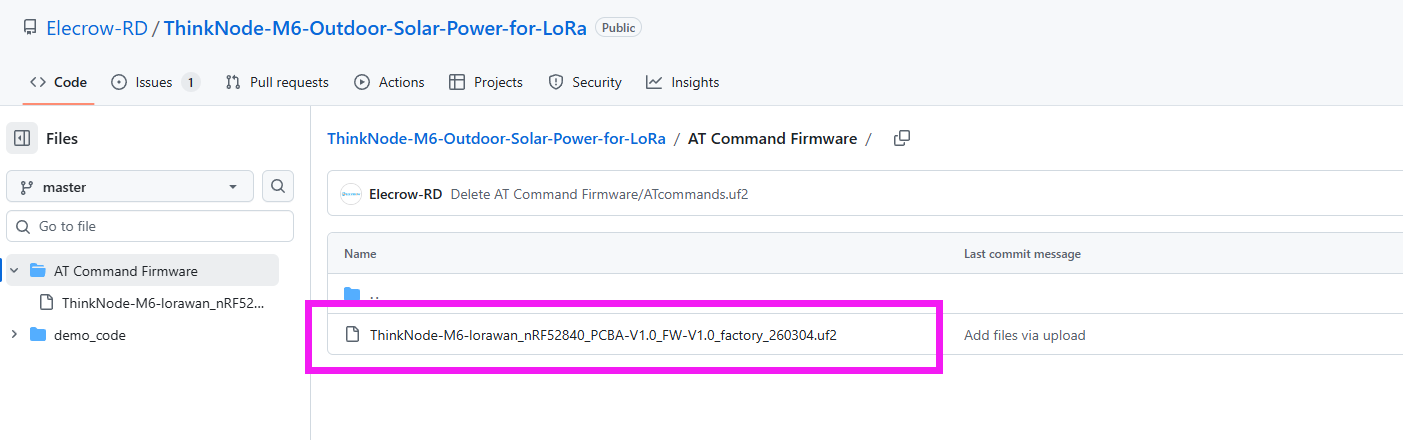

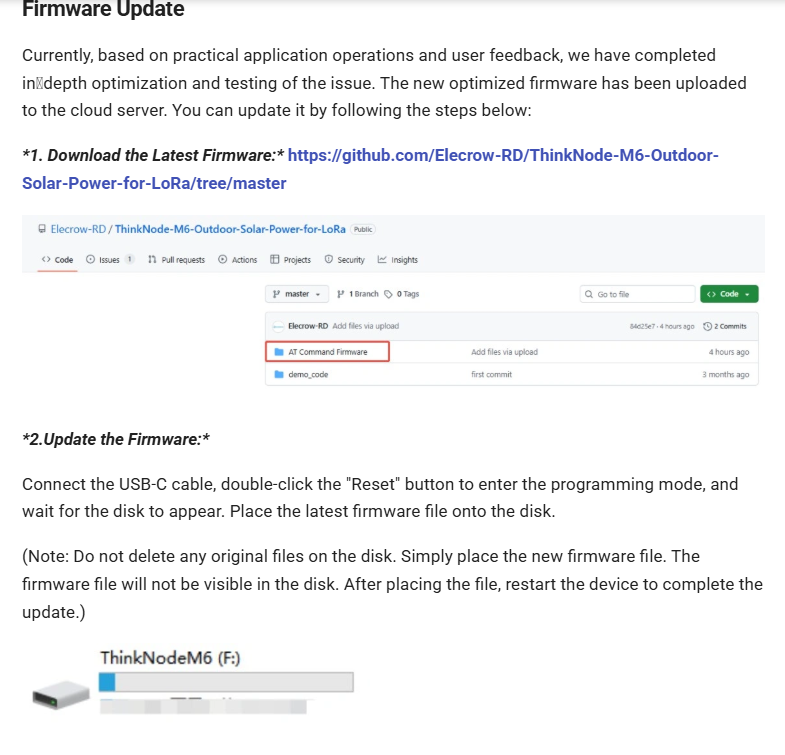

Hi RobotSquirrel,
The new firmware has just released. Here in the link there are firmware and instructions. Pls have a look.
https://www.elecrow.com/wiki/ThinkNode_M6_Outdoor_Solar_Power_for_LoRa_Powered_By_nRF52840_Supports_GPS-868_MHz.html
