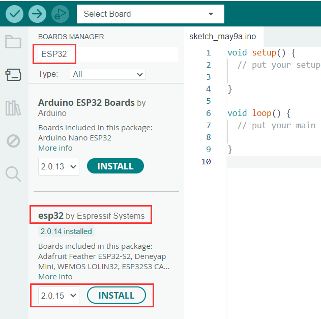

  1. ESP32 should install version 2.0.14/2.0.15.

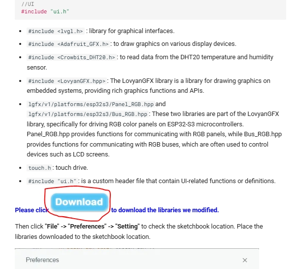

  1. Use the library files we provide:
Download the libraries we modified.
Then click "File" -> "Preferences" -> "Setting" to check the sketchbook location. Place the downloaded libraries in the sketchbook location.
Example images: (may be different from the actual ones)
CrowPanel DIS07050H 5":
download libraries from:
https://www.elecrow.com/wiki/ESP32_Display_5.0-inch_HMI_Arduino_Tutorial.html#install-libraries
CrowPanel DIS08070H 7'':
https://www.elecrow.com/wiki/ESP32_Display_7.0-inch_HMI_Arduino_Tutorial.html#install-libraries
CrowPanel DIS06043H 4.3":
https://www.elecrow.com/wiki/ESP32_Display_4.3-inch_HMI_Arduino_Tutorial.html#install-libraries

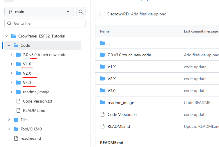

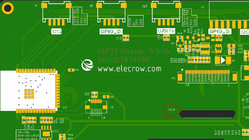

  1. Use the proper example codes.
    For some sample codes, we have different versions adapted to different hardware versions.
    So pls use the sample codes corresponding to the hardware version of your device.
    Example for hardware version on the device :
Example for the hardware version marks for which the code is applicable:
