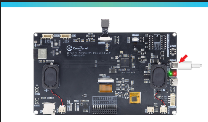

This problem was likely caused by connecting to the wrong interface. The port indicated by the arrow in the image below is the correct interface for downloading the program and connecting to the serial port; the USB 2.0 interface below is not.
