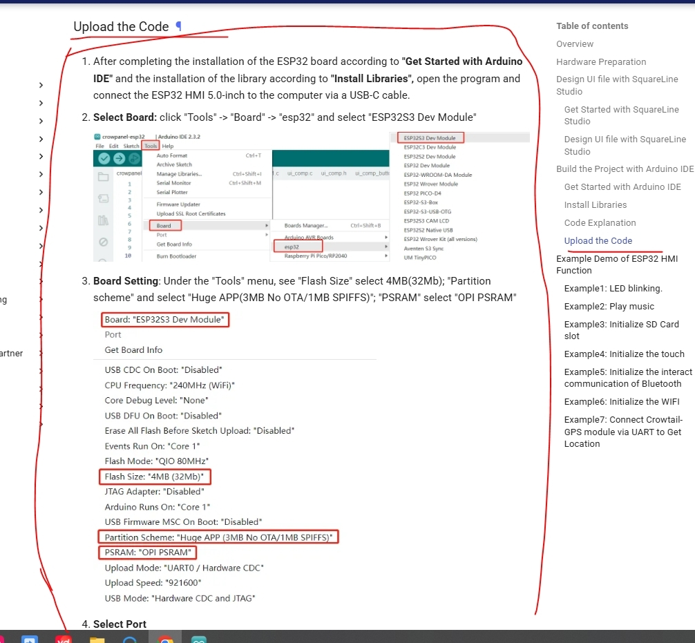

  2. The configurations in the Arduino IDE can only be set according to the following .

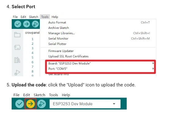

    https://www.elecrow.com/wiki/ESP32_Display_7.0-inch_HMI_Arduino_Tutorial.html#upload-the-code
    [Photo]
    [Photo]

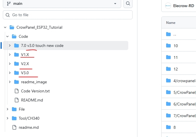

  4. Use example programms corresponding to the hardware version of your device
[Photo]
[Photo]
https://github.com/Elecrow-RD/CrowPanel-ESP32-Display-Course-File/tree/main/CrowPanel_ESP32_Tutorial/Code
