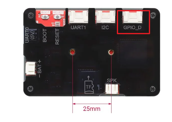

If I want to pair this CrowPanel 2.8"-ESP32 HMI 320x240 Display (SKU DIS04028H-1) with a Bazzer or speaker, what products do you have to match it?
Answer:
https://www.elecrow.com/crowtail-speaker-p-1660.html
https://www.elecrow.com/crowtail-buzzer-p-1223.html
Either of these can be connected to the GPIO_D interface.
Alternatively, the customer can purchase a separate speaker and connect it to the SPK interface. SPK interface type: PH2.0-2P. power of the Speaker needs to be 3w.
