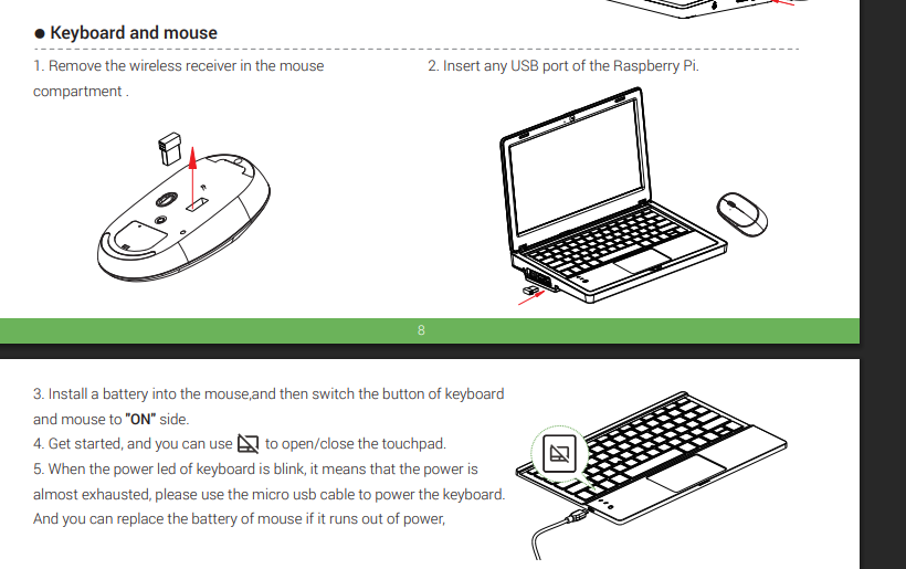

Please check the following:
  1. Have you removed the wireless receiver and plugged it into the USB port? (The receiver is usually inside the mouse.) Please refer to the diagram below for mouse and keyboard usage instructions.
  2. Are the button of the keyboard and mouse switched to "on" side ?
