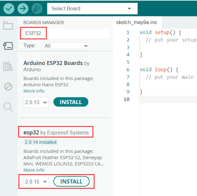

1. ESP32 should install version 2.0.14/2.0.15. [Photo]
[Photo]

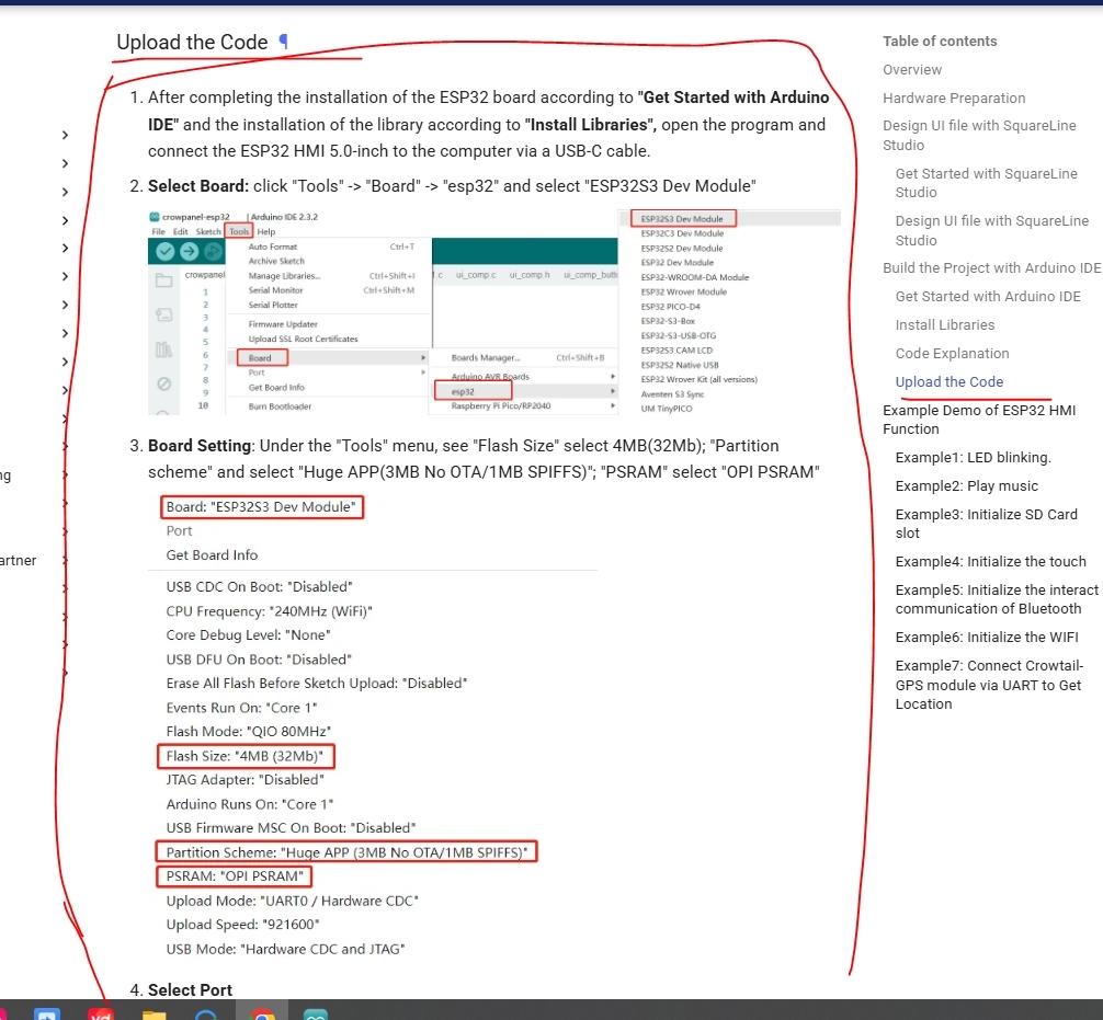

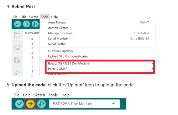

  1. The configurations in the Arduino IDE can only be set according to the following .
    https://www.elecrow.com/wiki/ESP32_Display_7.0-inch_HMI_Arduino_Tutorial.html#upload-the-code
    [Photo][Photo]
    [Photo]
    [Photo]

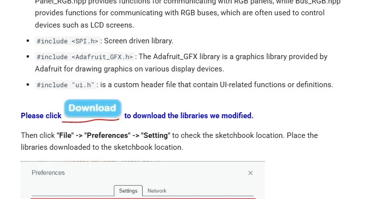

  2. Use the library files we provide:
    https://www.elecrow.com/wiki/ESP32_Display_7.0-inch_HMI_Arduino_Tutorial.html#install-libraries
    [Photo]
    [Photo]

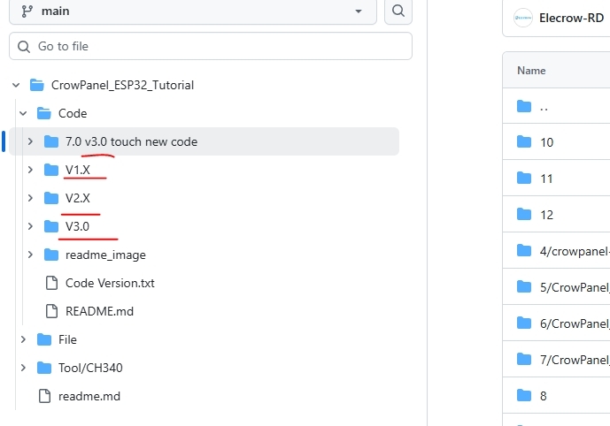

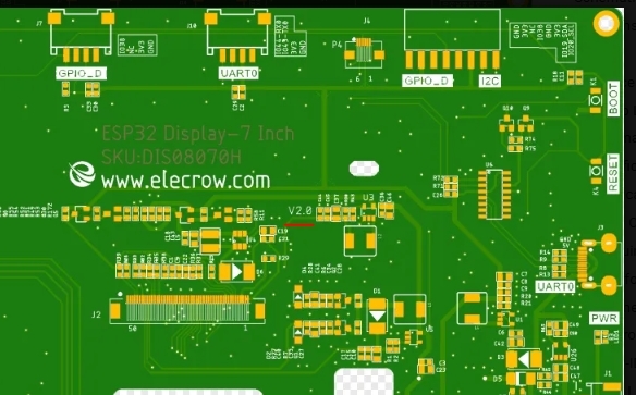

  3. Use example programms corresponding to the hardware  version of your device [Photo][Photo]https://github.com/Elecrow-RD/CrowPanel-ESP32-Display-Course-File/tree/main/CrowPanel_ESP32_Tutorial/Code
