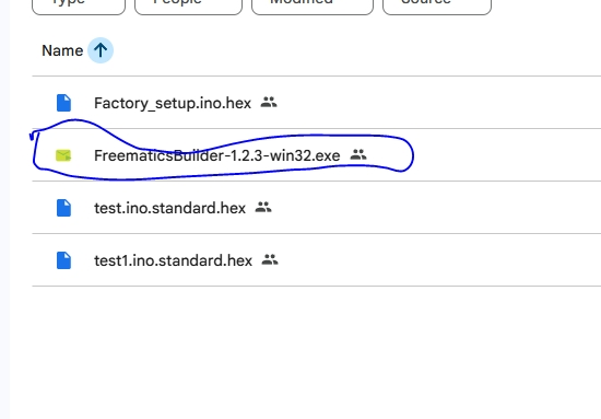

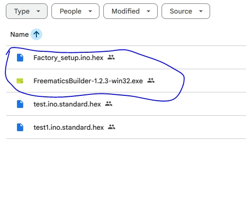

a. Download the files from the following link:
https://drive.google.com/drive/folders/1u3dM3MmVcqQohH0HXi3NS1On3vyvnA8j?usp=sharing
b. Click to install the following program. Note that you need to use a Windows computer to install it.

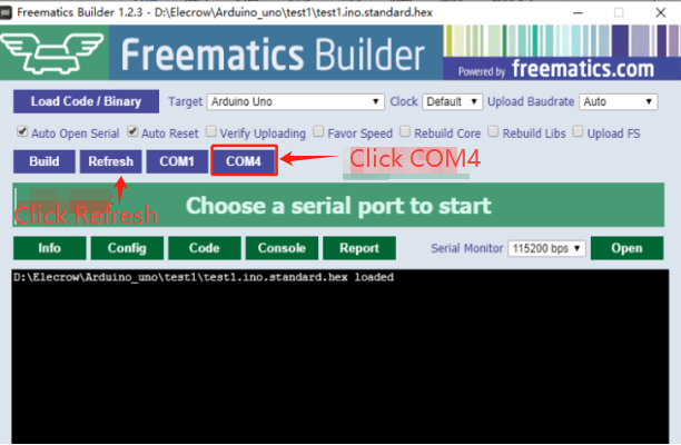

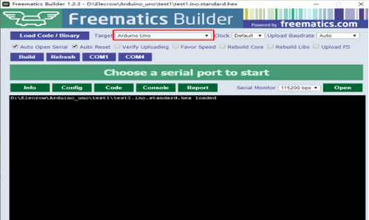

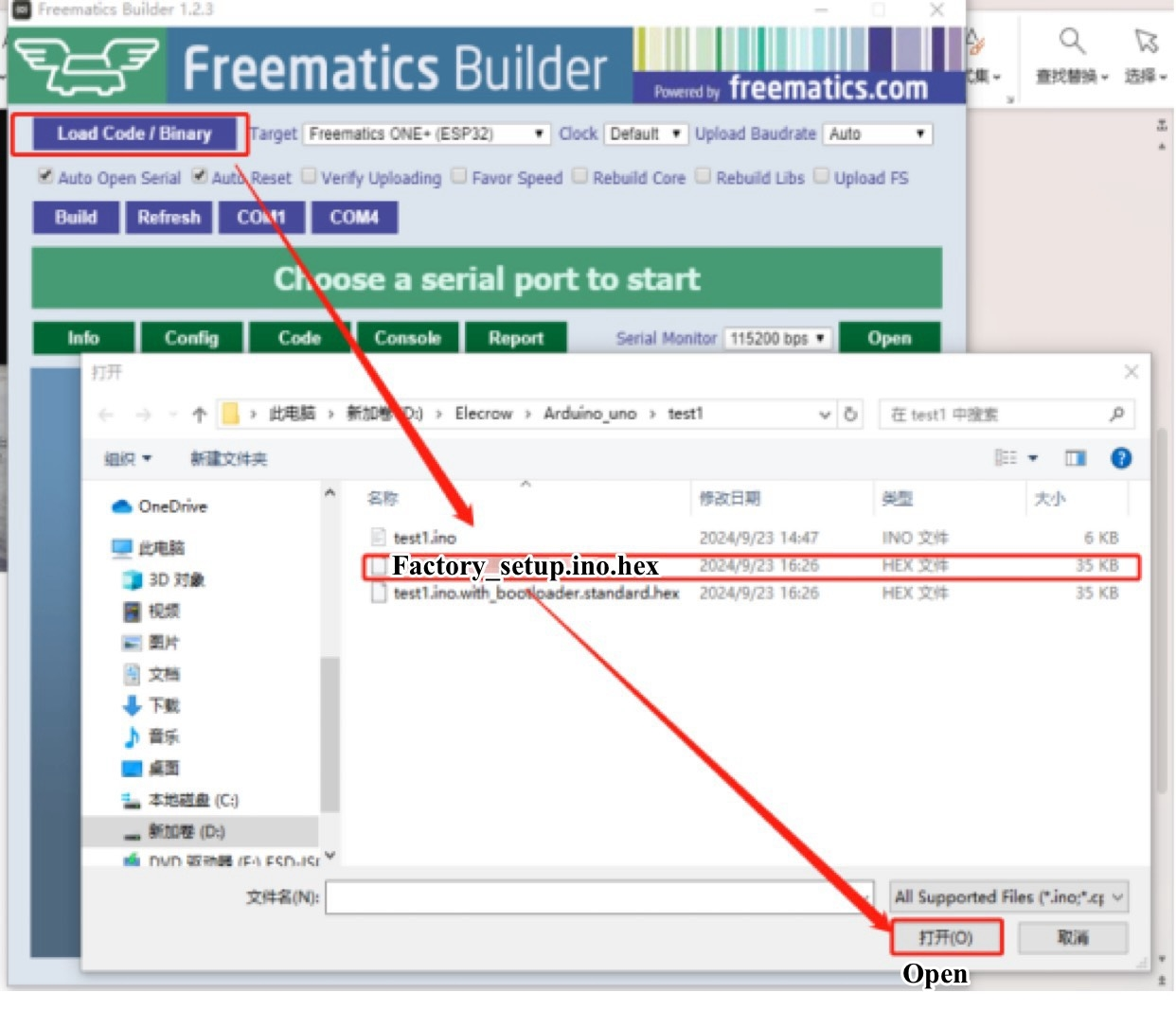

c. Connect the “all in one kit for arduino" to the PC, then Open the installed software and follow the steps below:
(the "Factory_setup.ino.hex" file can be downloaded via the link above)
