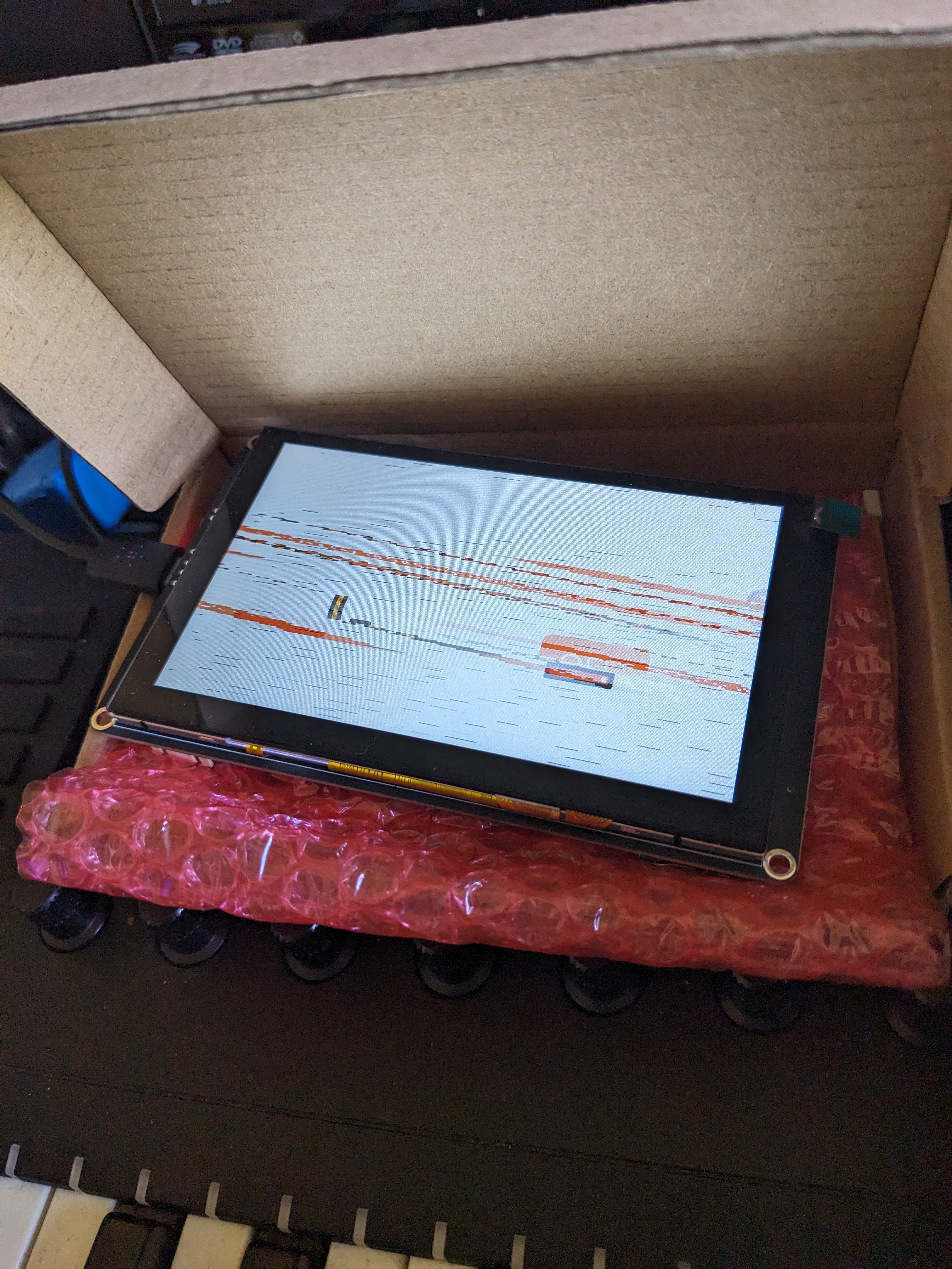

Hi,
I've got the advance 5 panel and I'm using the v1.0 "4.3_5.0_7.0_platfromIO" example
I've made no other changes except added ElegantOTA, and when I upload a new binary I get crazy horizontal screen distortions and tearing. The forum won't let me post a photo or I would
In a previous project I've tried all sorts of recommendations, changing timings, power, ram types, nothing has made any difference,
Does anyone have any ideas?
Thanks in advance

  • edited November 27
    Hi Jennie
    The Sku is DIS02050A-1
    The order number was from you guys: 251698
    The website won't let me post links or images, it always throws a 500, but this is part of the url on your site
    /crowpanel-advance-5-0-hmi-esp32-ai-display-800x480-ips-artificial-intelligent-touch-screen.html
    Thanks

    During WiFi OTA (Over-The-Air) updates, WiFi may: consume significant CPU resources, consume PSRAM bandwidth, enter a prolonged critical section, disable some interrupts (including those required for I80/RGB refresh), block LVGL's disp_flush, and cause DMA inter-frame refresh latency, resulting in screen tearing, horizontal distortion, jitter, and screen glitches.
    Recommended solution: Pause LVGL refresh during OTA updates.
    Thanks!

  • Hi Jennie,
    Unfortunately, I've already tried that, it made no difference. I'm beginning to wonder if the screen is faulty, it's not just a little distortion it's quite extreme, and it seems to do it on wifi in general, even when not doing OTA, just basic wifi operations. I can't embed a photo for some reason, but I've attached one
    Cheers
