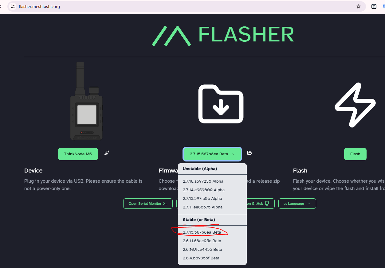

  • Dear deadbeef ,
    Please try to flash the device to the stable firmware version.
    Thanks!

  • Hi Jennie
    Just tried.. same problem.
