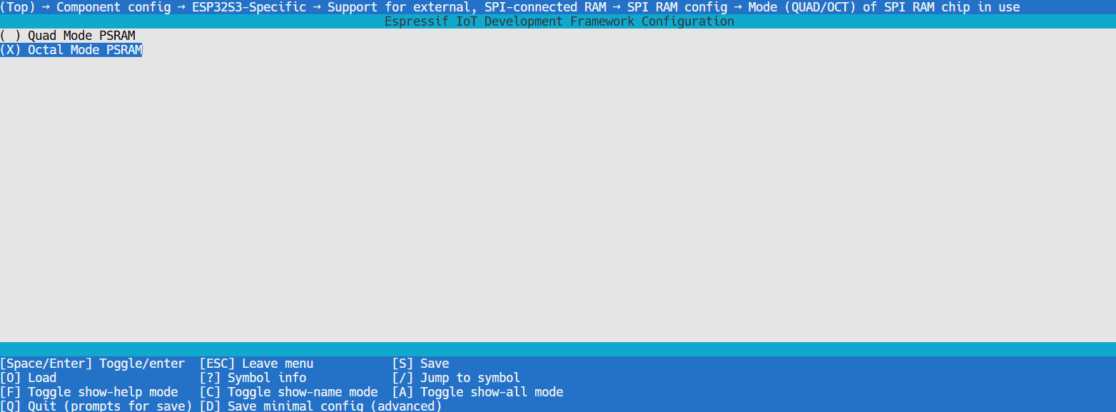

In the
Component config
>ESP32S3-Specific
menu, enable theSupport for external, SPI-connected RAM
option.
In the
SPI RAM config
menu that appears when you enable this option, change theMode (QUAD/OCT) of SPI RAM chip in use (Quad Mode PSRAM)
setting toOctal Mode PSRAM
. (This part is set differently depending on the HMI type. Please refer to Lesson 02 of the CrowPanel tutorial video.)
