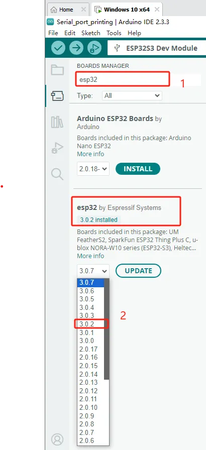

    Thank you for your patience and sorry for the late reply. Please follow the troubleshooting steps below:
    1 Did you upload the program successfully? You can check it by looking at the information printed in the output window of the Arduino ide. You can also take a screenshot and show it to us.
    2 Please note that you need to install version 3.0.2 of ESP32. Installing other versions will result in errors.
    3 After completing the Esp32 download, replace the files in a directory:
    Open the "ESP32S3_120M"(https://drive.google.com/drive/u/1/folders/1npWkVzctd7e0Y6H5hahk8uxGhy9idxCz) file we provided, copy a copy of the file from that folder to the corresponding path in ESP32, and replace it;
    (path reference: C:\Users\Administrator\AppData\Local\Arduino15\packages\esp32\tools\esp32-arduino-libs\idf-release_v5.1-bd2b9390ef)
    Thanks! Have a good day.
