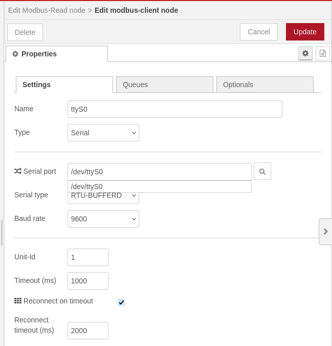

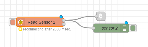

I have Pi Terminal 7" and try to connect with RS485 temperature and humidity sensor. I use Node-RED to reading value from sensor and display out to its dashboard. I used Modbus-Read node and specified "/dev/ttyS0" as a serial server. But it's always reconnecting for Modbus-Read node.

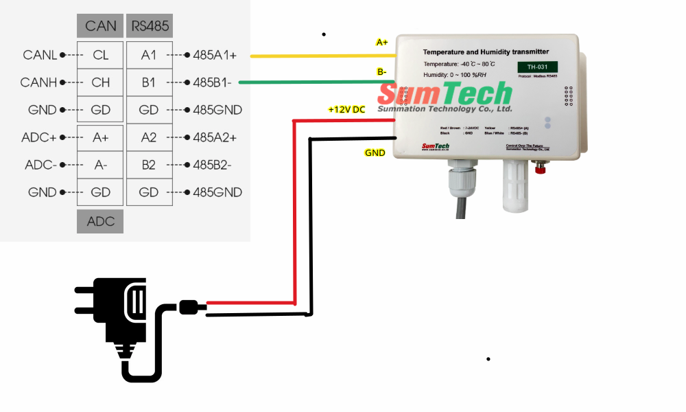

    I connected Pi Terminal to sensor via RS485 port.
    On Node-RED flow I use Modbus-Read node then output to debug "sensor 2". But there is no debug output.
    Inside Modbus-Read node I configured to read holding registers address Slave ID 6, address 0, 2 values.
    For the server settings Node-Red recognized only one serial port which is "/dev/ttyS0"
    My concerns is the serial port that I have setup is incorrect.

    The sensor must share a common ground with the RS485 interface.
