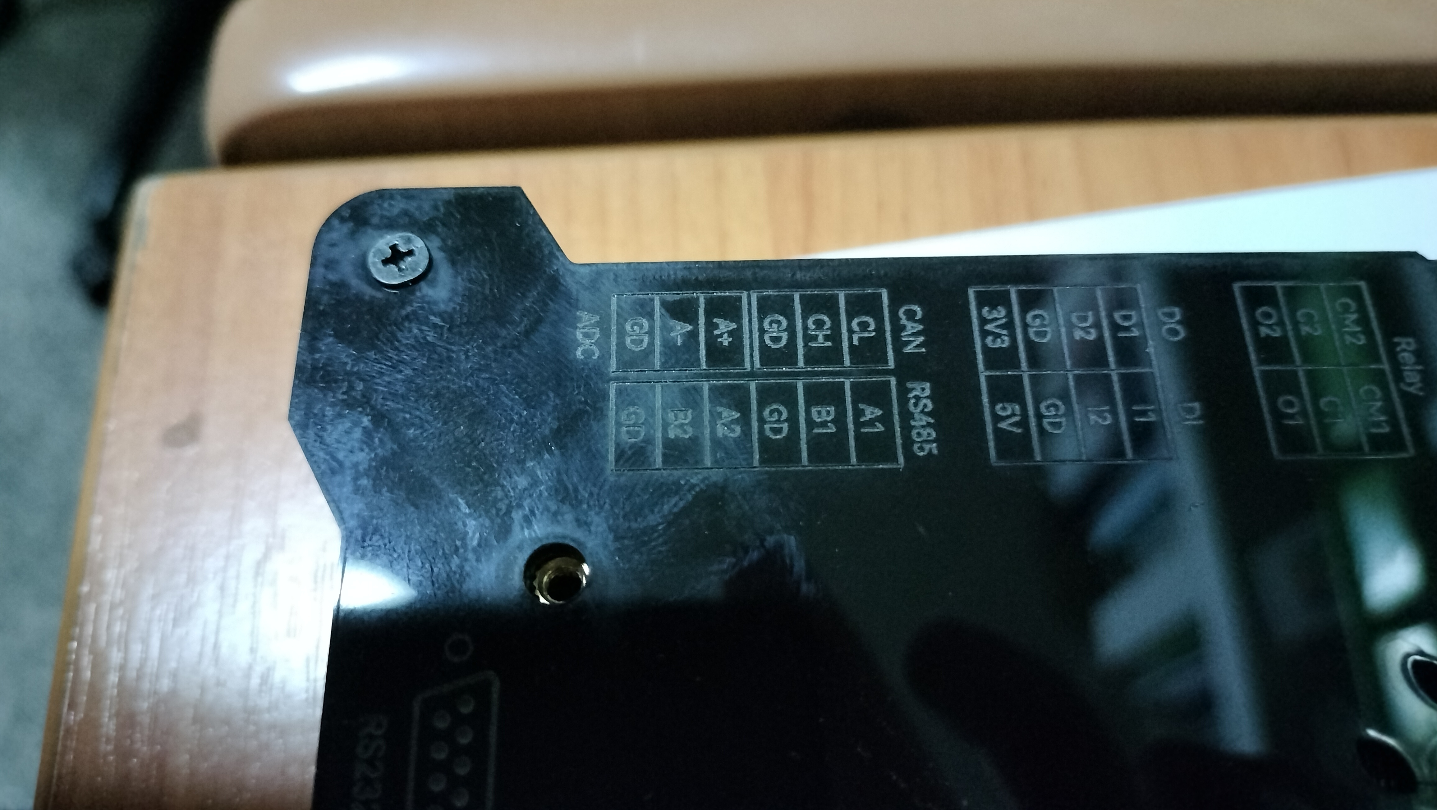

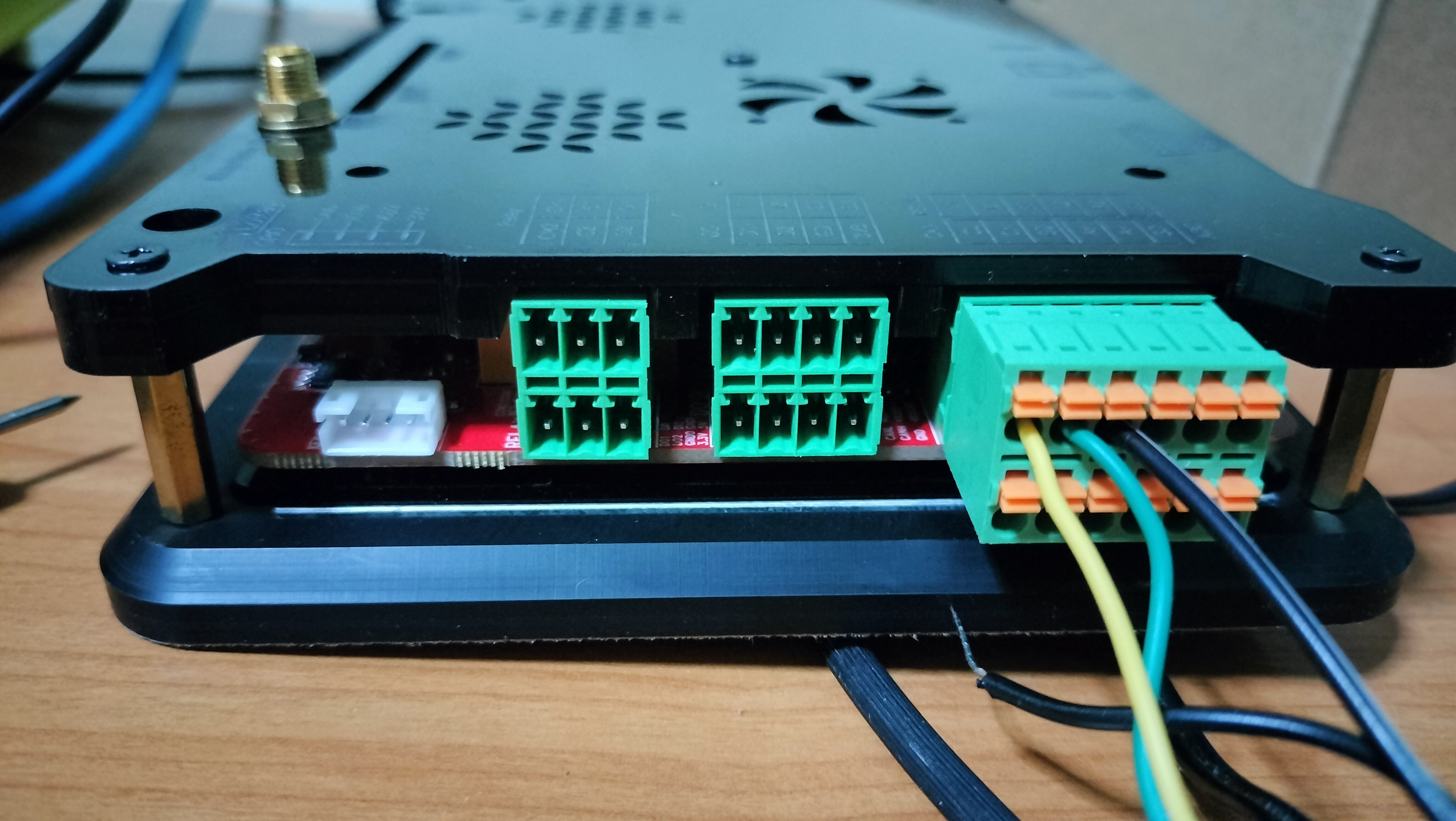

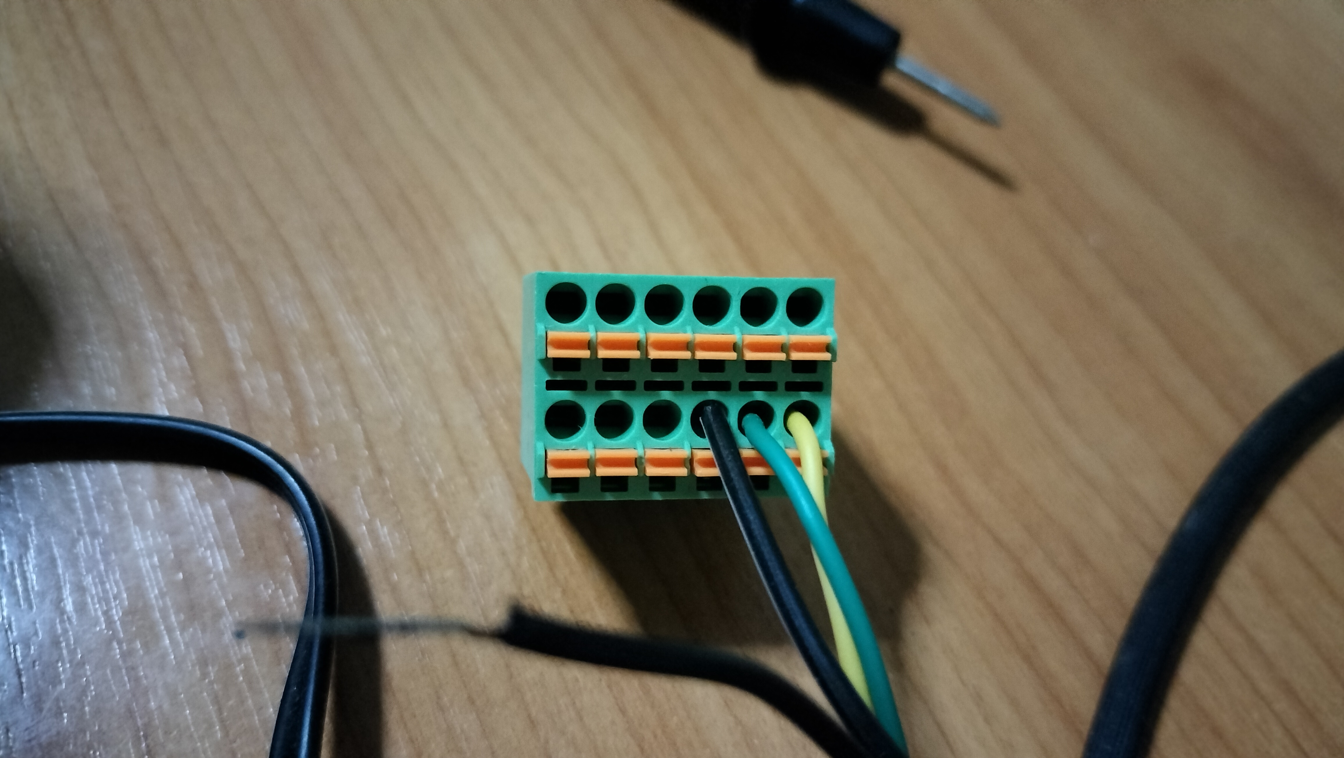

    The photos
    show how I connected.
