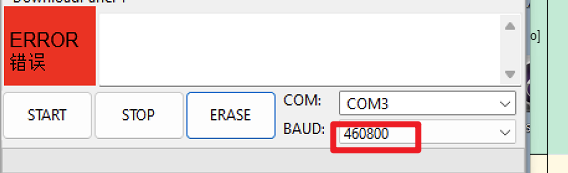

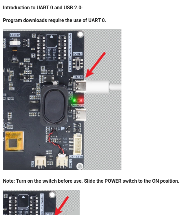

Please ensure the UART interface is connected to a USB port on your computer.

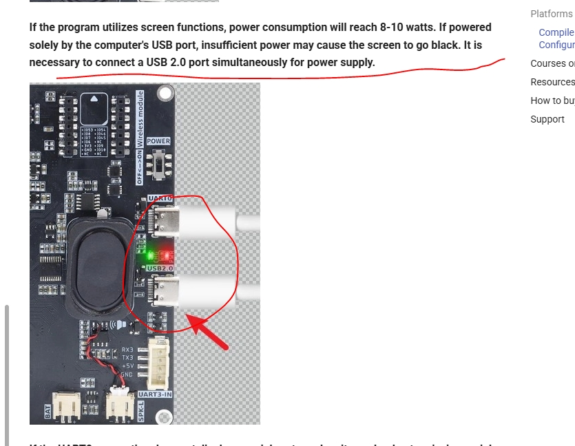

Also, it's best to connect both USB ports to power source to avoid insufficient power supply.
Please also send us a photo of your wiring connection.
Furthermore, if it still fails, please try reducing this value in the image below.
