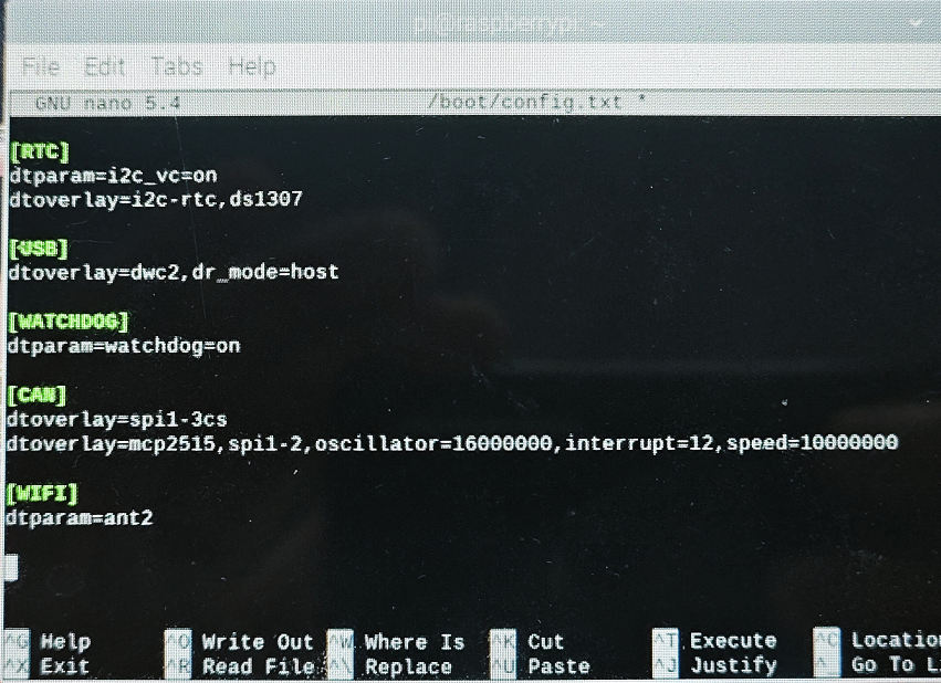

Hello, What is the correct dtoverlay configuration to enable the CAN transceiver in the Pi Terminal?

Hi, andrewhuster, The accompanying image has prepared this: [Photo]

Hi, andrewhuster,
[Photo]
