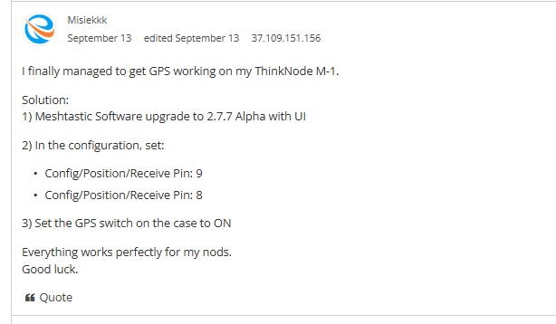

  • edited September 13
    I finally managed to get GPS working on my ThinkNode M-1.
    Solution:
    1) Meshtastic Software upgrade to 2.7.7 Alpha with UI
    2) In the configuration, set:
    • Config/Position/Receive Pin: 9
    • Config/Position/Receive Pin: 8
    3) Set the GPS switch on the case to ON
    Everything works perfectly for my nods.
    Good luck.
