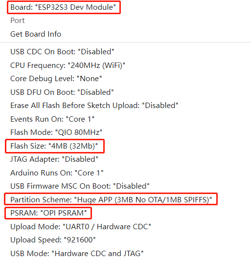

3 In tools, follow the following configuration
If you have any questions, please feel free to contact me!
