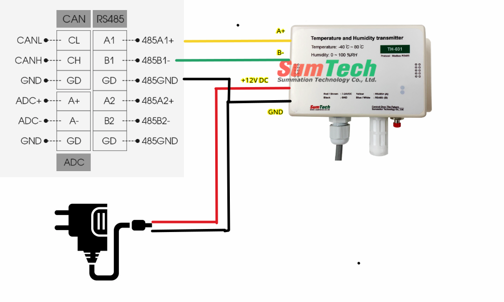

  • Hi Jennie,
    I connected Pi Terminal to sensor via RS485 port.
    On Node-RED flow I use Modbus-Read node then output to debug "sensor 2". But there is no debug output.
    Inside Modbus-Read node I configured to read holding registers address Slave ID 6, address 0, 2 values.
    For the server settings Node-Red recognized only one serial port which is "/dev/ttyS0"
    My concerns is the serial port that I have setup is incorrect.
    Thank you.

    Hi mshettha,
    The sensor must share a common ground with the RS485 interface.
  • Hi Jennie,
    I have tried to share common ground among Pi Terminal RS485 Port with the ground sensor. But I still can not read data from sensor using Modbus-Read node on Note-RED.
