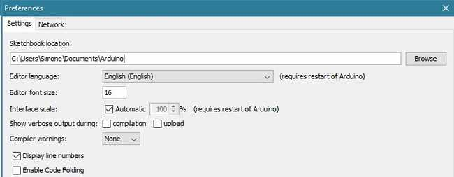

You can find or change the location of your sketchbook folder at File > Preferences > Sketchbook location.

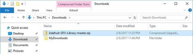

Go to the directory where you have downloaded the ZIP file of the library

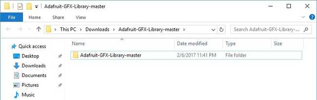

Extract the ZIP file with all its folder structure in a temporary folder, then select the main folder, that should have the library name

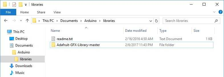

Copy it in the "libraries" folder inside your sketchbook.

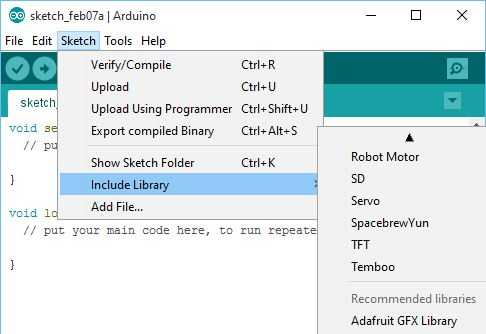

Start the Arduino Software (IDE), go to Sketch > Include Library. Verify that the library you just added is available in the list.
