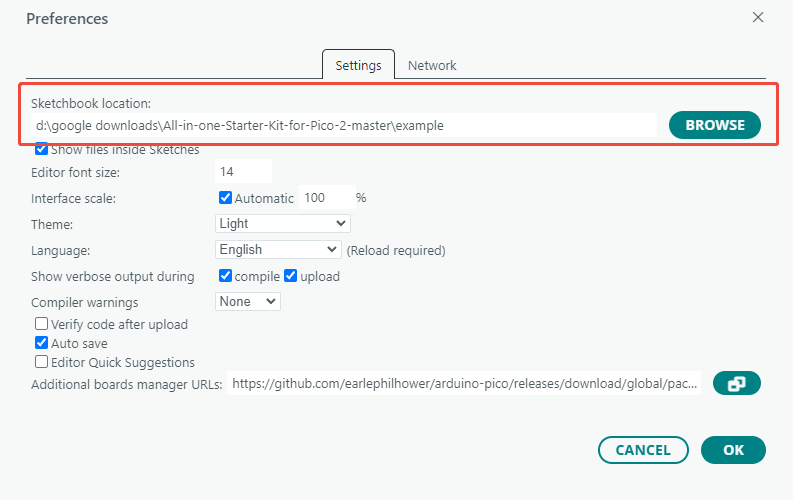

Here's how to do it:
Go to File > Preferences in the Arduino IDE. In the "Sketchbook location" field, copy the path shown there and paste it to any blank document file and then add “\libraries” to the end of the path — this is your Arduino runtime library path.

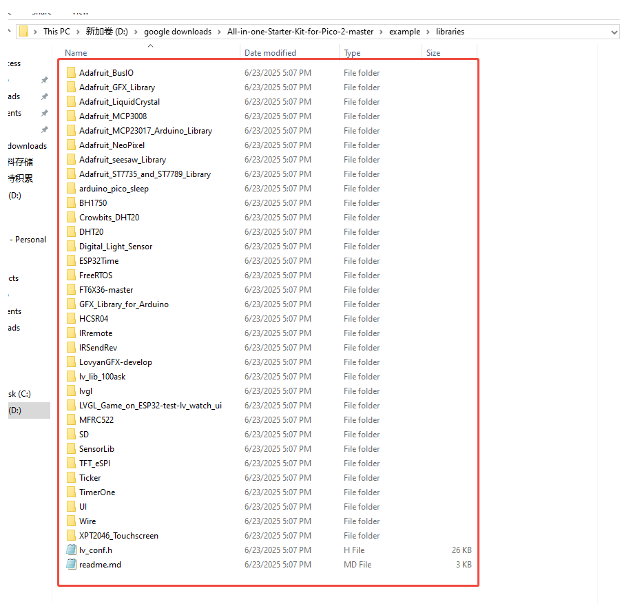

Open this path in the computer file folder, then copy and paste all the contents(as shown in the image below) from the Libraries folder you downloaded into it.

(1) Configure Additional Boards Manager URLs:
In the Arduino IDE, click on File → Preferences, then paste the following URL into the "Additional Boards Manager URLs" field:.  Then Click OK.
 https://github.com/earlephilhower/arduino-pico/releases/download/global/package_rp2040_index.json
(If you need to add multiple URLs, click the icon on the right to open the pop-up window and add URLs. Different URLs need to be separated by line breaks, and then click OK.)
